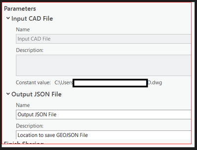

Hello,
A tool created for conversion, worked fine on ArcGIS Pro, but while/when published the Input value changed to constant value, need kindly help
Environment: ArcGIS Pro 3.2.1, ArcGIS Enterprise 11.1

Further in research,
CAD file data type is considered as a non-simple feature. Thus it cannot be used as a user input.
https://enterprise.arcgis.com/en/server/10.5/publish-services/windows/parameter-data-type-transforma...
