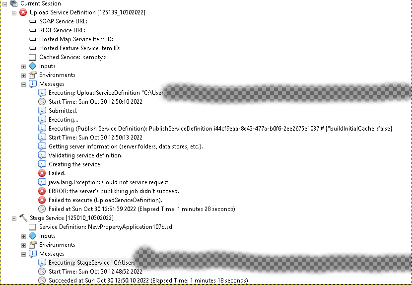

The output of the results window in ArcGIS Desktop shows this:
Stage Service - Passes
Upload Service Definition - Failed
Results WindowResults Window
