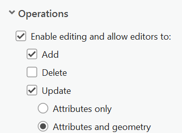

@MunroKevin Thanks for sharing your steps. This issue is actually resolved in ArcGIS Pro 3.0. Feature layer editing options were redesigned to match editing operations in ArcGIS Online, ArcGIS Enterprise, and ArcGIS Server. If you upgrade to the latest version, you'll see that there are separate Update and Delete options which will be honored when you overwrite the service. You can read more about this in Configure a web feature layer (see step 5).
