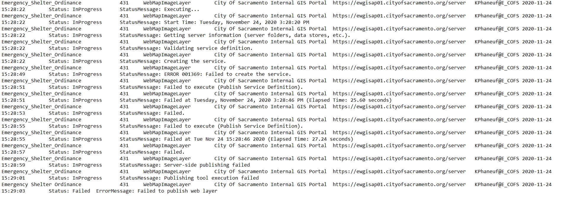

We have published a service mistakenly with the data copied to the server rather than by reference. We moved the data to a registered folder on the server and tried to overwrite. However, it continues to fail with an error 001369 Failed to Create the Service and Failed to execute (Publish Service Definition). We are able to publish a new service as registered to the referenced folder. Is there any reason why the overwrite should fail when going from non referenced/copied data to referenced data?
ArcGIS Enterprise 10.8.1
Publishing from Pro 2.6.2
