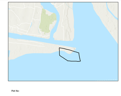

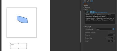

WahidIbneZakir007
Hi @TanuHoque
Thank you for your response.
I have already followed these steps described in the blog but when I print using the widget I get the same error.
as you can see in the image plot no is supposed to be printed because I have used dynamic text (value) there but it is not being printed.
Here is a screen shot of the .pagx file
Eagerly waiting for your reply
Thank you
