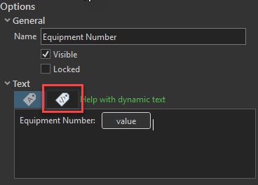

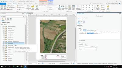

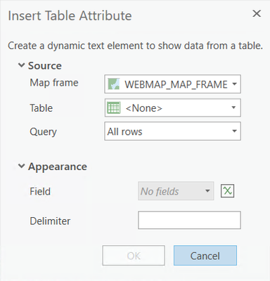

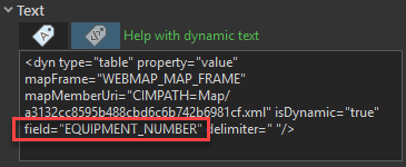

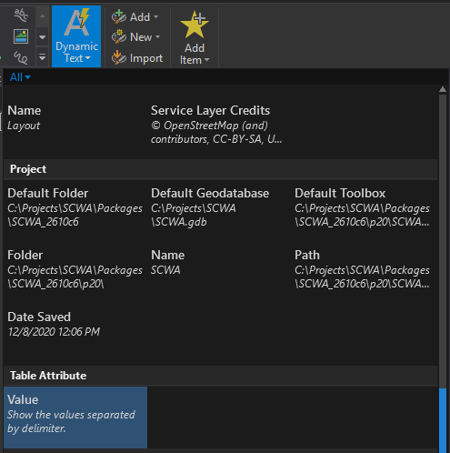

3.  Add dynamic text by going to Insert > Dynamic Text.  Scroll down to Table Attribute > Value
4.  Select the Map Frame, the layer for Table, set Query to Visible Rows, and specify the Field that will display the dynamic text.  Optionally, specify a Delimiter
5.  Draw a rectangle in the layout where you would like the dynamic text to be placed
6.  In the Element pane, click the Text View button

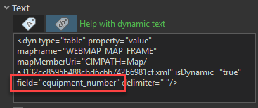

7.  Change the field to all lower case

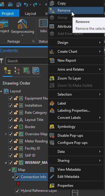

8.  Once all the dynamic text has been added, remove the layer(s) used to create the dynamic text from the Map Frame
9.  After the layer(s) have been removed, go to Share tab > Layout File and export the .pagx to a folder

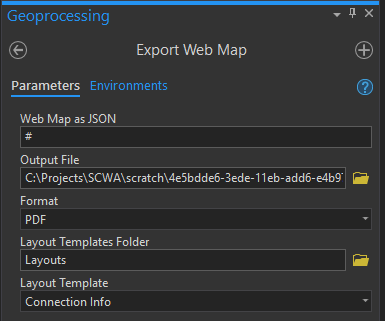

10.  In the attached Dynamic Printing.tbx, open the Export Web Map tool.  Specify the Format, choose the folder you exported the .pagx file to in step 9 for Layout Templates Folder, choose a Layout Template, and then Run the tool

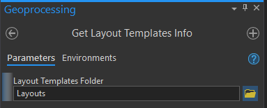

11.  In the DynamicPrintService.tbx, open the Get Layout Templates Info tool.   Choose the folder you exported the .pagx file to in step 9 for Layout Templates Folder and then Run the tool

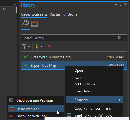

12.  Click on the Analysis tab > History to open the History pane
13.  Before proceeding make sure ArcGIS Pro is connected to your ArcGIS Enterprise organization.  Right-click on the Export Web Map tool > Share As > Share Web Tool

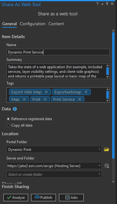

14.  Specify a Name for the print service.  Under Data, choose the option Reference registered data.  Optionally, specify a Portal Folder and share the service (i.e. to your Organization)
15.  Click Configuration tab.  For Execution Mode specify Synchronous and set the Message Level to Info

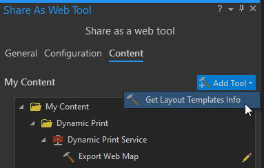

16.  Click the Content tab.  Click the Add Tool and select the Get Layout Templates Info tool
17.  Analyze and Publish the service

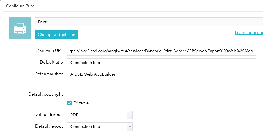

4.  Add the Print widget to your Web Application
5.  For the Service URL, specify the path to your print service including the GPServer/Export%20Web%Map.  Ex:  https://jake2.esri.com/arcgis/rest/services/Dynamic_Print_Service/GPServer/Export%20Web%20Map
Optionally, specify a Default title, Default author, Default copyright, Default format, and Default Layout

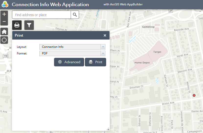

6.  The custom print service will print dynamic text for all visible features.  If you want to limit the extent to a particular feature, you can add the Filter widget and filter based on a unique attribute.
7.  Open the Print widget, choose the Layout and Format, and then click Print

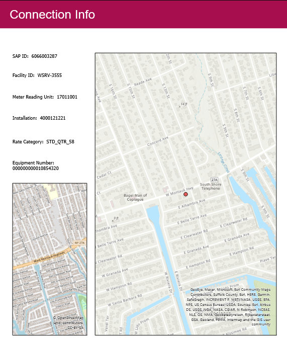

Here is an example of an output PDF created with the dynamic text on the left:

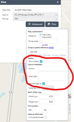

@MHasan
Sorry I didn't see this message from Jan, 2021. In case you still need the answer or someone in the future looking for an answer for this....
To allow your end user insert an value for a dynamic text, here is what you need to do:
  1. Add a custom text element in your layouts. As you saw that in the tutorial you mentioned above.
  2. On the web app side, you need use Web Application Builder Print Widget.
    • on the print widget, click Advanced button and you will see the custom text element you defined in your layout.
    • all you end users need at this point is to enter a value in the text box and click Print.

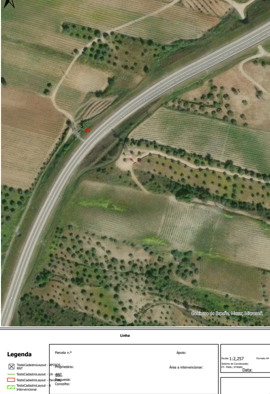

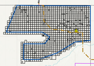

Hello,
I am finding that this works for me, except that it doesn't reflect the filter that I'm using on the dynamic text layer. It's displaying all of the values that *would be* visible in the map extent, if the filter weren't applied.
The blue outline area is the layer I'm using for dynamic text, it's filtered to show just this one, but the text is still listing all the projects in this area.
One thing that I noticed that is different between your dynamic text element and mine is that yours points to a .xml path whereas mine points to .json.
Is it possible that it has something to do with that?
Thank you for this helpful post.

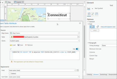

I am also wondering if there is a way to display attributes from the first record only, when the filter widget is designed to return multiple records?
I think the answer currently is no... In ArcMap, when setting the dynamic text, you can choose between All rows | Visible rows | Custom query.  Your steps advise to use 'Visible rows" which means it will only work properly as long as only 1 feature is selected.  I had a look at Custom query but all my attempts at an SQL statement failed eg SELECT Top 1 * FROM <mytable> WHERE OBJECTID IS NOT NULL
Many thanks for getting me this far.
TanuHoque
Thanks @MoyaCalvert_01
You are right, we don't have such option.
So, you want to see attributes from the 1st row even when the feature is not visible?
the above sql is very specific to SQL Server database. If your data are stored in a SQL Server, then you can write a query like this in the query builder...
objectid IN (SELECT TOP 1 objectid FROM NEWENGLAND_COUNTIES order by STATE_NAME)
if your underlying database is Oracle, or PostgreSQL or FileGDB or something else then this syntax might look different.
Here is a screenshot of a dynamic text element that shows state-name from the first row. Pls note in my layer, I only had data from 3 different states from the New England region.
pls let me know if you have any questions.

Hello, I've been having a problem using this tutorial, I followed everything accordingly, even the troubleshoots on the comments, however it doesn't seem to work for my case.
After putting the printing widget on the Web App and switching the Service URL to the correct one I try to print nothing shows on the map and the dynamic text is empty, for example after Apoio: is an empty dynamic text  box and as you can see it shows up empty, like on the print attached:Captura de ecrã 2024-12-16 165242.png

RafaelGoncalvesCGI
@TanuHoque I did that, when I opened the test.aprx I went to the layout and this is what was in there:
So to make it sure, I think it's referencing the layers correctly, because it has the same definition as the original aprx, I managed to make the symbology show up, but the dynamic text isn't showing up.
However when I press the value on the right side it shows this:
Does this mean that it isn't going to any table?
TanuHoque
@RafaelGoncalvesCGI
seeing "<None>" next to the Table in your screenshot makes me believe that the referencing is not getting set correctly.
On the first screenshot, there are two modes for the Text property - Tags view and Text view. Switch to the Text view and you will see the definition of your dyn text element in some xml format. There you can see if the path is missing or not.
I have a feeling that something is not doing as expected in your py code.
RafaelGoncalvesCGI
@TanuHoque this is the Text View:
It has the field="n_apoio" as it should be, it's even on lower case, like specified on the tutorial, I can't seem to understand why it isn't working.
Thank you for all the time your spending to try and help me!

RafaelGoncalvesCGI
@TanuHoque maybe I was misunderstanding the tutorial, but I managed to fix it:
It is now filling the information I needed, what I did to solve it was I didn't remove the layers used to create the dynamic text from the Map Frame, this way it managed to fill the dynamic text boxes.
It is also checking the Table as shown bellow:
I also had to leave the mapMemberUri with a CIMPATH:
