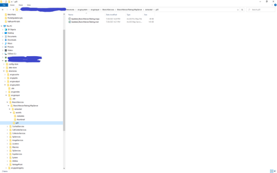

While I was dealing with that, I noticed that the directory arcgisinput was also quite large. According to the description, this folder
Stores source files (such as maps and data) for services that you publish.
It also appears to have no cleanup mode defined, which would imply that this folder is not meant to be cleared out. But I don't really understand what these source files are doing, if anything, and can't find any good documentation that explains it in more detail.

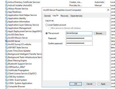

The domain arcgisserver system account handles all writes to the input folder when you publish or overwrite a service, not users.  When you delete a map service, the service's input folder and subfolders should be deleted as well.  If the input service name folder and subfolders do not delete when you delete a map, image or gp service, then you have or had other problems, probably related to sharing, where the arcgis server domain account could not fully access all the directories.

so if your data is not on the server make sure you are using a domain service account for ArcGIS and that the folder is registered as a network share and that the service account has access to it
