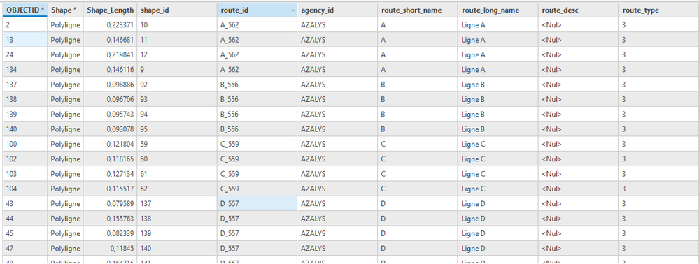

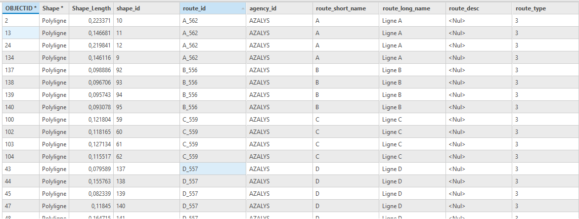

Here is the table of the layer when deployed:
(The right of table is just infos like the line's color...)
Here, one shape is equal to one route.
As you can see, all my routes are identified by line (route_id, route_short_name...) and by shape with the primary key "shape_id".
This "shape_id" doesn't match with my table LineVariant who identify the routes in the data model.

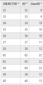

Here my LineVariant table:
Each routes is here define by the ID column. The Line_id identify a group of ID (a group of routes so).
The ID of LineVariant don't match with the shape_id: if i choose the LineVariant ID "10" , it will not match with the shape_id n°10

From your screenshot of the output of GTFS Shapes To Features, it looks like most routes have multiple shapes.  For instance, route_id A_562 has four shape_ids: 10, 11, 12, 9.
The GTFS shape_id is not used in the LineVariants table.  One reason is that shape_id can be a string, and we chose to use numeric values as IDs for our Public Transit Data Model.  Also, although we provide tools to convert from GTFS to the Public Transit Data Model, you could instead use some non-GTFS source of transit data.  Also, as I said before, the shapes.txt file is optional.  So, you should not consider the ID field in LineVariants equivalent to the shape_id field in shapes.txt, but you are correct that LineVariants are conceptually equivalent to shapes.  But...yeah, there is no good way to join the LineVariants table to the output of GTFS Shapes To Features.
