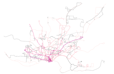

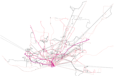

I know this post is from quite a long time ago, but I wanted to report back on the functionality that was requested.
With the release of ArcGIS Pro 3.4, the Calculate Transit Service Frequency tool (the successor to BetterBusBuffers) has been enhanced to include an option to output transit statistics using actual route shapes instead of straight lines. To use this option, you have to run the GTFS To Public Transit Data Model tool in ArcGIS Pro 3.4 or higher to with the option to use your GTFS shapes.txt file to generate the new LVEShapes feature class in the public transit data model.
Instead of this:
You get this:
