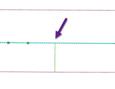

For some reason, your street data did not end up with vertices at the locations where the StopsOnStreets intersect them:
Without vertices at those locations, travelers cannot travel between the streets and the transit lines, hence why the transit lines are never being used.

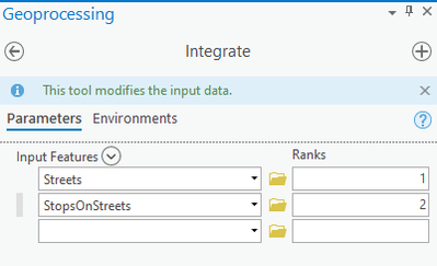

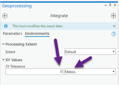

3) Run the Integrate geoprocessing tool with the inputs configured as follows:
The Integrate tool will create vertices at the intersections of the input feature classes. Setting the XY Tolerance to 0 ensures that your input features will not be moved at all.
