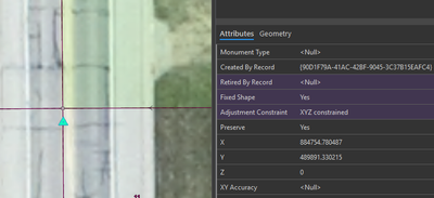

When I attempt to enter a Fixed Point (for an updated PLSS Corner) using Absolute X, Y, Z I noticed that the X and Y fields are not populating about half of the time.
I have captured a few examples of what I am talking about, I am glad I caught this soon rather than later.
Entered Easting Northing for PLSS Corner
Second attempt with the same corner.
Is this something any of you have experienced? Is there a way to troubleshoot or fix this, or is this a known bug I have missed.

We are working to fix it as part of ArcGIS Pro 3.6. We recommend opening a case with technical support.
AmirBar-Maor
AmirBar-Maor
@GrantCountyGISSup
This issue has been fixed as part of ArcGIS Pro 3.6
