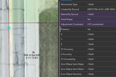

When I attempt to enter a Fixed Point (for an updated PLSS Corner) using Absolute X, Y, Z I noticed that the X and Y fields are not populating about half of the time.
I have captured a few examples of what I am talking about, I am glad I caught this soon rather than later.
Entered Easting Northing for PLSS Corner

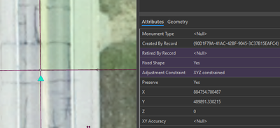

Second attempt with the same corner.
