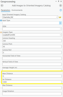

However, you also should be able to edit the Near/Far distance in the Add Images to Oriented Imagery Catalog tool. Here is a screenshot
vickyduran_AerialSphere_1-1706638496256.pngvickyduran_AerialSphere_1-1706638496256.png
If the Near and Far distance fields are not showing in the Attribute table, then you can use the Add Oriented Imagery Fields tool to manually add them. The OrientedImagery Catalog Management User Guide indicates that If a value is undefined because there is no attribute field or the value of an attribute is null, the default value in the OIC properties will be used.

  •  If Far/Near Distance parameters are not present in the attribute table of the OI layer or they are but with the same value for all the records, the field can be removed from the attribute table and the value can be set using the Geoprocessing tool called "Update Oriented Imagery Dataset Properties (Oriented Imagery". T
  • If Far/Near Distance parameters exist in the attribute table with different values for most of the records, the attribute table value will take precedence over the dataset property value. You can manually edit these parameters directly in the attribute table, just make sure you save the changes for them to be applied.
