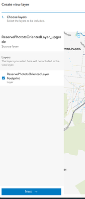

Can't create oriented imagery view layer?

I can’t create a view of the oriented imagery layer, only the footprint layer. If the layer is shared with groups to capture more images through QuickCapture, how can we control which groups can edit and which can view only?

BrandonGuo
When I try to create view under layer, inside "Create view layer" tool, only footprint layer showing up, not the "oriented imagery layer".
