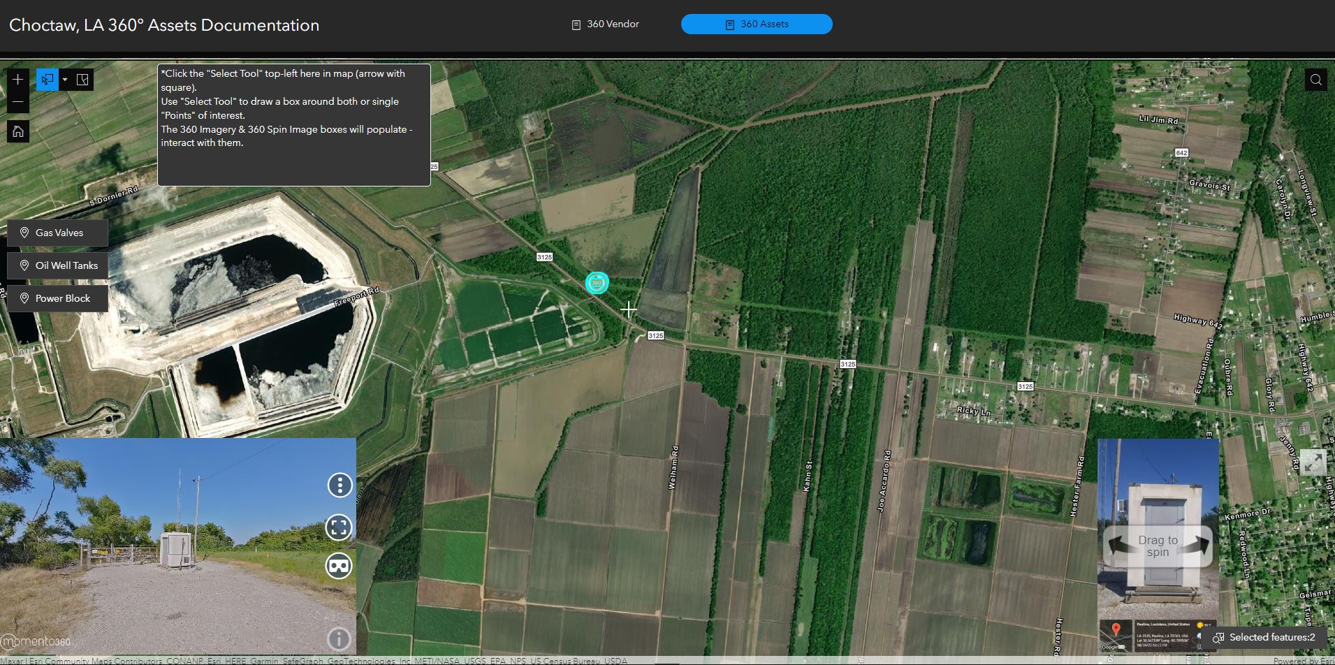

ESRI Needs a "Basic" 360° Image/Video Viewer (Widget) for its native Web Mapping Application as well as for some Instant Apps. Create the OIC Catalog with multiple 360° Images and/or video as well as point file data assigned to each.
Here is another similar example I used with Experience Builder & 3rd-party 360° Online Image Vendors; here you can see the 360° image on the bottom left and the 360° Feature Spin Video/Image on the bottom right associated with each of my Data Asset Points.
Here is the Link to my Experience - please follow the instructions listed on the site:
https://experience.arcgis.com/experience/a1b01644f61b43d2aceb5c66f902d905/page/360-Assets/

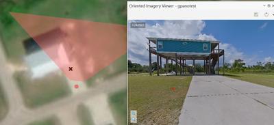

RandallRebello
Hi @OwensS & @PeterBecker ,
I had a look at this data against the google street view standard tags which offers an explanation of the XMP tags. This is the link... https://developers.google.com/streetview/spherical-metadata
I did notice that GPano:PoseHeadingDegrees is missing in the XMP data. Similarly in the Exif metadata the tag EXIF_GPSImgDirection is also missing.  The current version of OI GPTools reads the  EXIF_GPSImgDirection value for CamHeading. The upcoming release will also read the GPano:PoseHeadingDegrees tag from XMP for CamHeading. However in your images both these tags are not present. The GPTool will assign the value -9999 (unknown direction) if a default direction is not specified.
I did put 0 as the direction for one of the images you shared and it seemed to be correct. So maybe there is a north correction being applied and that is the direction to use.  But it will need some tweaking.
Randall
