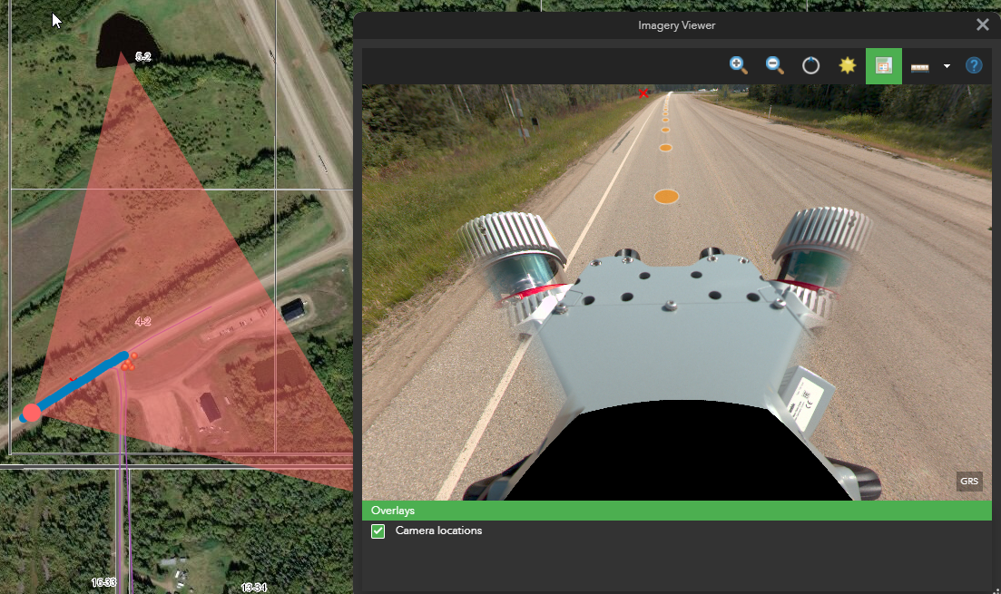

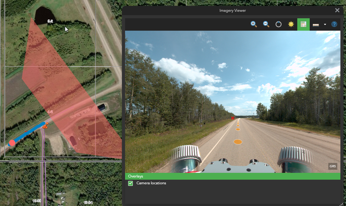

Hi - I'm using the WAB Oriented Imagery Tools and when looking at the coverage graphic in the map, when my 360 is approx level (0 pitch) the coverage area appears to be incorrect, clipped further then an the image centre than it should be.
If I tilt the 360 viewer down by approx 40° then the coverage polygon appears as I believe it should in the first instance.

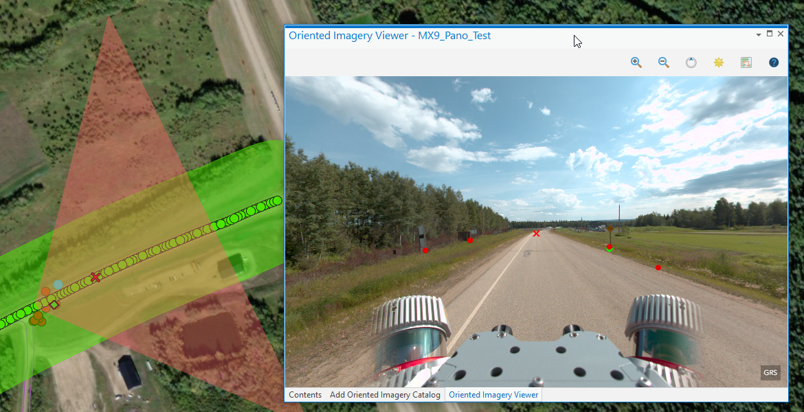

When viewed in the Pro the coverage area is correct when there view is level no pitch (lowest screen capture).
I have accurate pitch values, approx 90° for all images.
I'm wondering is the elevation service in AGOl affecting the camera height in anyway ?  or is the WAB OIC widget calcing the coverage incorrectly?  or something else?

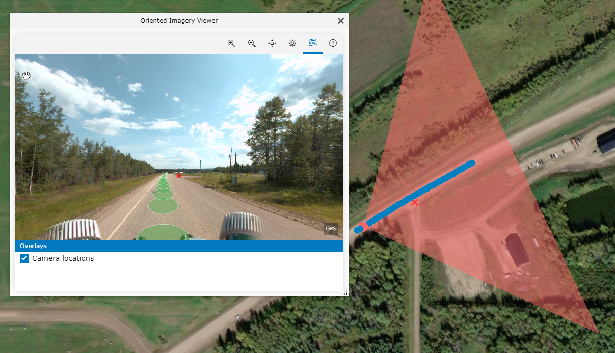

The confusing part, to me, is why the coverage polygons look correct when using the published OIC in Pro (screenshot 3) . But using the exact same published OIC in a 2D web map with the WAB widgets (July release) the coverage polygon appears truncated (screenshot 1).
Only when tilting the 360 image down 40° does the base extend to the exposure point of the image (screenshot 2).
This suggests to me the elevation of the image used in the web map is higher than it really is?
I'm not sure what the affect of the DEM assigned (or not) when adding images to the OIC is and whether may affect things, but again why would it be different in Pro to the AGOL web map?
