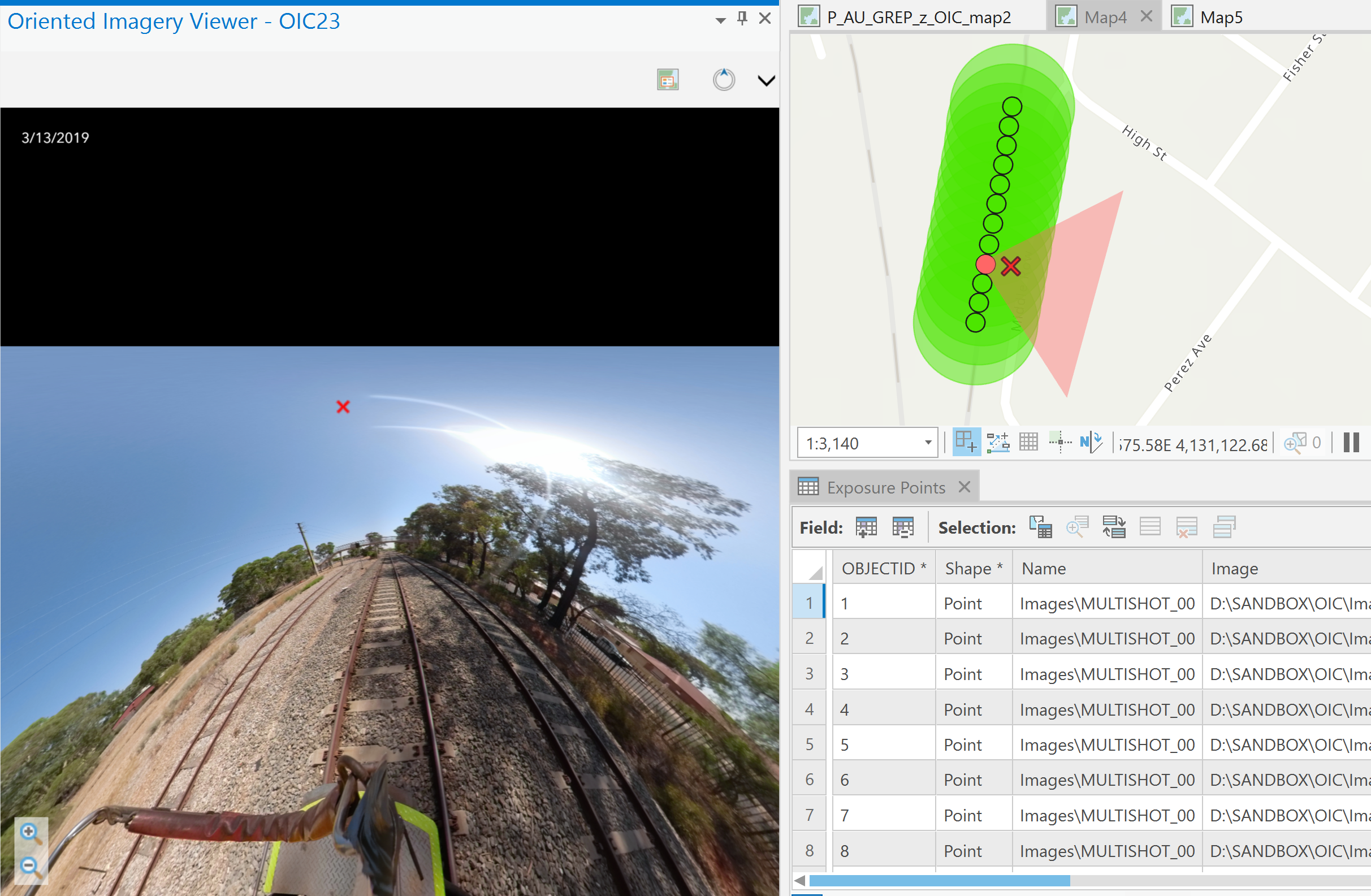

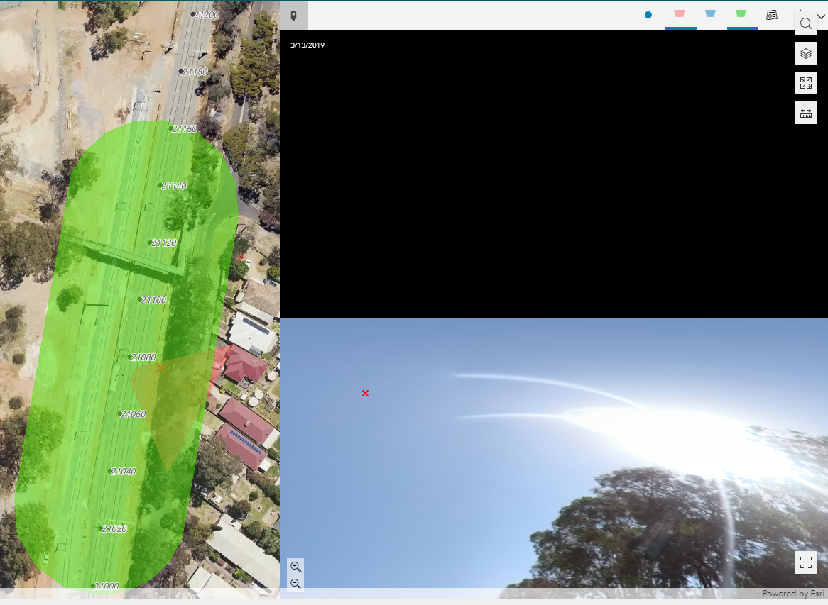

I had an OIC that was displaying spherical imagery (OIType=B) but now it looks wrong. Top half of the image is a black band with that 'fisheye' look.
Wrong in both EB App and using Pro OI Addin.
The odd thing: these were previously OK.
Help?!

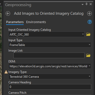

PeterMacKenzie2
Thanks @GordonSumerling . Yes they have an OIType=B and I rechecked the Imagery Type = Terrestrial 360 Camera
arcpy.ManageOrientedImagery.AddImagesToOrientedImagery("OIC21", "Folder", None, r"D:\SANDBOX\OIC\Images", ".jpg", '', '', None, "Terrestrial 360 Camera", "Bubble", "0", "90", "0", "360", "180", "2.5", "0", "30", "50", "0")

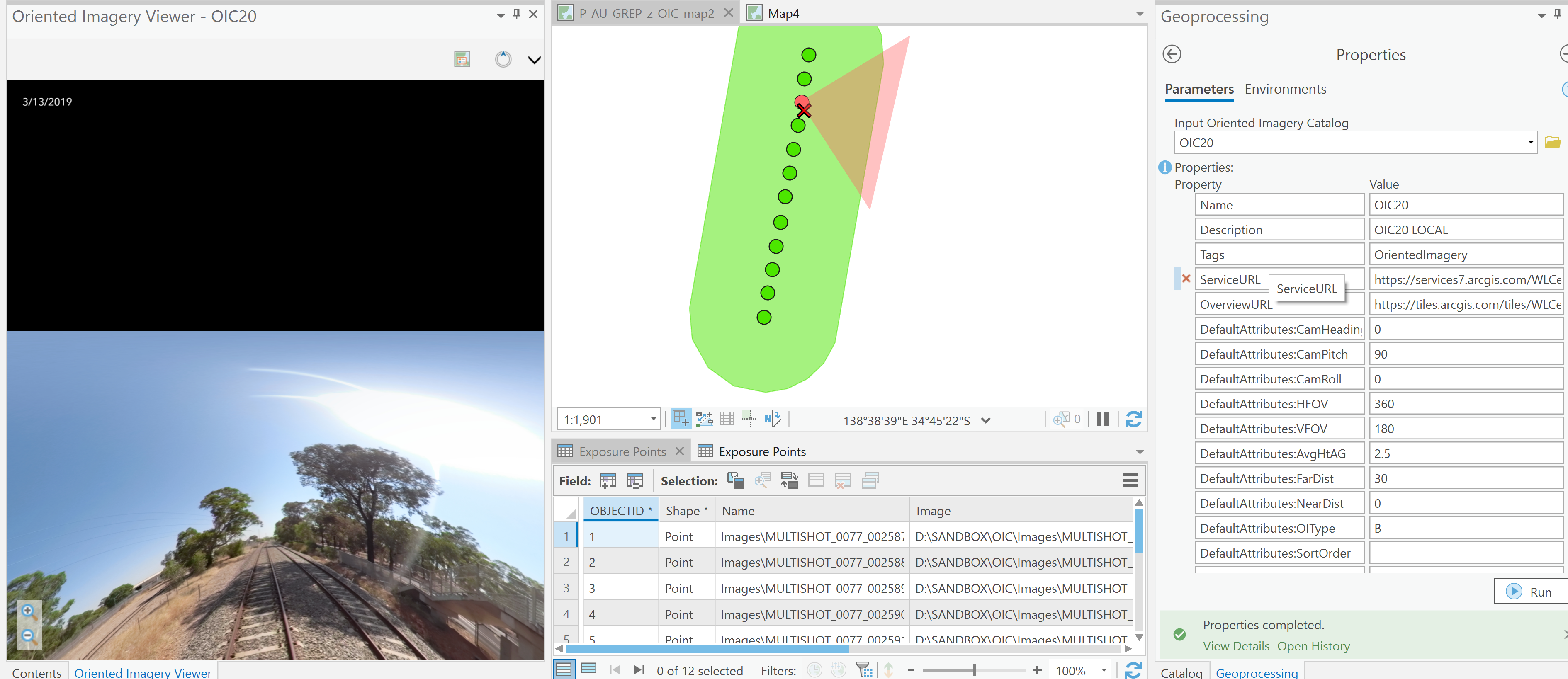

RandallRebello
HI Peter,
Check you VFOV value in the exposure table attribute table. The value might be showing as 90. (This happens if you have the image projection type defined as equirectangular in the image metadata. Its a bug and will be fixed.) It should actually be 180. Also use the Properties GPTool in the OIC Toolbox to check the default properties. VFOV should also be 180 there.  However this VFOV value is only used incase a value for a particular record is not defined. You can also delete the VFOV field in the attribute table if all your records have the same VFOV value. (This is just a way to reduce the database size if you have a large number of records.)   But then make sure there is a value defined in the default properties.
For the issue you are facing it looks like you have a 90 degrees defined as VFOV. If that is not the case send me a single image and I can try to figure out whats going on.
