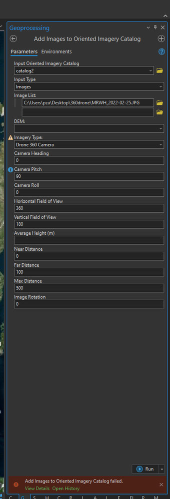

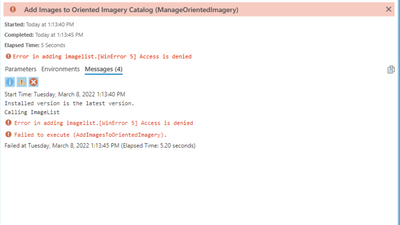

Hi,
I am using the Oriented Imagery Management toolbox. I have created a Catalog and I m trying to add the images (Imagelist) to the catalog using, Add Images to Oriented Imagery Catolog.
I am still getting this error: Access is denied
Can anyone help me with that?

Hi Zach,
I tried to replicate your steps and it worked for me.  This error generally occurs when a file cannot be accessed by the program.
What version of ArcGIS Pro are you using?
Can you try a couple of things as well.
1. Run ArcGIS Pro as administrator.  and try to add.
2. Copy to a different location and try to add.
3. Try on a different machine.
How were these files copied onto your machine? Did you download a zip file from the cloud and unzip the contents.  Sometimes zip files are blocked by windows. After downloading , you would need to bring up the properties of the zip file and unblock it. Then unzip the contents.
This seems like an error from the OS. You can google 'winerror 5 access is denied' to see possible solutions.

Giota_Zach
Hi RandallRebello,
Thank you very much for reaching out.
1. I m testing a single image, loading from my local disk.
2. It is a JPG file should I create a txt file with the name? I tried it but did not work.
3. I have added the full path including the image extension.
4. No it is not on a network of shared resources.
I can't send the 360 image file since it is more than 9MB.
