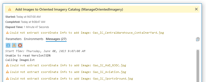

Hi, I did have a look again and read the annexes. I updated the bucket policy and the CORS and now I get a VersionJSON error (see attached).

bogdanpalade2
The "VersionJSON" error I think it's unrelated to the "Could not extract coordinate info to add image" error. It appears when running all tools, but it doesn t influence the results.
