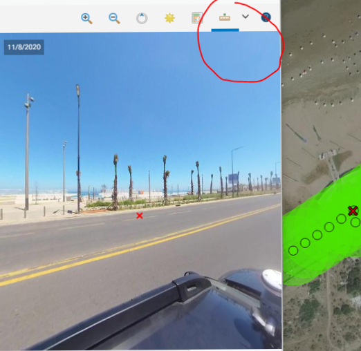

I have accurate Camera Heading,Roll,Pitch,X,Y,Z. It appears OIC does not use elevation data but rather Height above Ground. I am guessing it projects the little red x that you click onto the screen on the DEM and then translates that to the image. In my cause its really far off. See screenshot. Is this the case or do you suppose I am missing something else? I am also wondering how to get it to show the other image locations projected onto the image. Can they navigate from one image to the next by clicking on it IN the image instead of on the map?
Thanks in advance!
the little red x is pretty far off.

Interesting obseveration, if I click on one of the storm structures it picks the closest image. If I click just on the map, it doesnt.. Still think its a DTM issue.. Maybe...
by Anonymous User
Not applicable
Hi,
This is not a DTM issue.
There is an issue with the method we used to compute the best image for street-side images. It is a known issue. This will be updated in the next release and will resolve your issue.
