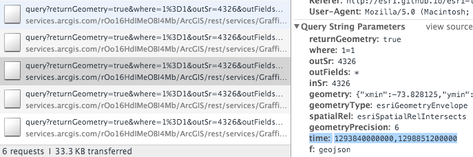

if you snoop the web traffic when running our sample​ you can see several gridded queries to the feature service which retrieve features in the current map extent and ask for filtered results via the parameter below
when we alter the sample to set timeFilterMode to client, the 'time' parameter is no longer included in requests.  in this situation, all features (in the current map extent) are retrieved from the service.  this means that users are able to manipulate the time extent in the application UI without forcing additional requests to be executed.
