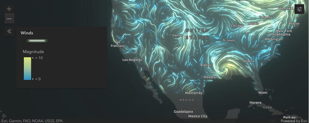

Hi, I want to create a layer display of a Wind animation "same as what is on the Windy website". when I created this layer so then I will add it to the ESRI basemap or my custom portal basmeap. can anyone guide me from where should i start?
John-Foster
@MajidALsiyabistart with this sample, you can use one of the buttons below the demo to view the code
https://developers.arcgis.com/javascript/latest/sample-code/layers-imagery-afrenderer/
