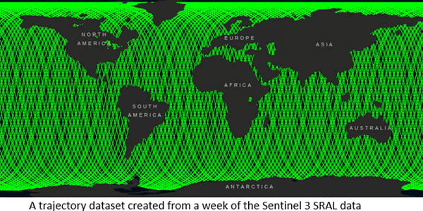

Using a week of level-2 altimetry data a trajectory dataset was created.  The trajectory dataset contains an SSH variable that is calculated on-the-fly from the data variables “mean sea surface level” and “sea surface height anomaly”.  The SSH variable is computed when “Add Data to Trajectory Dataset” is used to load the altimetry data into the trajectory dataset and the data type “Sentinel 3 SRAL” is selected. Below is the trajectory dataset created from Sentinel 3 SRAL data between 1/2/2022 and 1/8/2022. It contains 394 tracks (green lines) which reference 817,204 observation points.

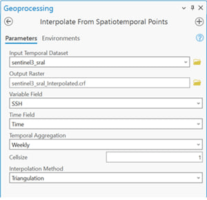

Next, using the “Interpolate From Spatiotemporal Points” tool a SSH raster was produced.  To enhance the visualization, the triangulation option for interpolating data was used.

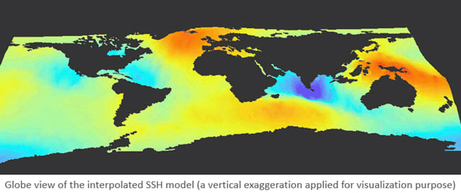

 A land mask is also used to clean the pixels on land. The resulting SSH raster dataset was then utilized as an elevation source in 3D, while also functioning as a raster layer draped over the elevation surface. This provides a clear depiction of the peaks and valleys present during this period in the ocean topography.

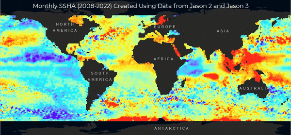

Calculate the average monthly SSHA
In these steps we use the SSHA data from the Jason 2 and Jason 3 feature classes to create independent multidimensional (time-series) rasters.  To do this, we will again use the “Interpolate From Spatiotemporal Points” tool – this time using the IDW option and calculate a monthly SSHA variable for each dataset independently.  Next, we merge the outputs from Jason 2 and Jason 3 using the “Merge Multidimensional Raster” tool.  The result, animated below,  is a monthly time series compilation of both Jason 2 and 3 ranging from 2008 to 2022.

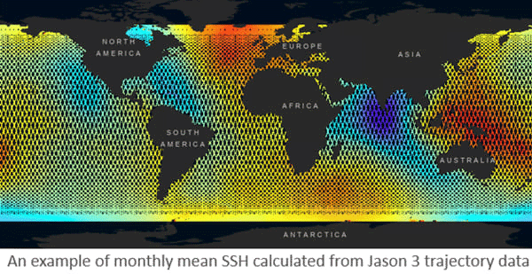

In this example, the goal is to compute the global average sea surface height utilizing the altimetry data points using both the Jason 2 and Jason 3 feature classes created in the previous step. Once again, the “Interpolate from Spatiotemporal Points” tool is used, this time selecting the “Mean” interpolation method to calculate the monthly averages for each feature class independently. The Mean option computes the average using the observation points within the designated pixel size and time interval, avoiding pixel extrapolation in no data areas and removes the introduction of errors.  Below is Jason monthly interpolated mean example created. The valid data area is between -180 and 180 and -60 and 60 (skewed in the polar regions).
 In analyzing the 2016 raster data from Jason 2 and Jason 3 (the one-year overlap maintained for data calibration purposes), we observed a discrepancy of 0.7 meters. Consequently, we applied a correction factor of 0.7 meters to the Jason 2 data prior to merging it with the Jason 3 dataset.

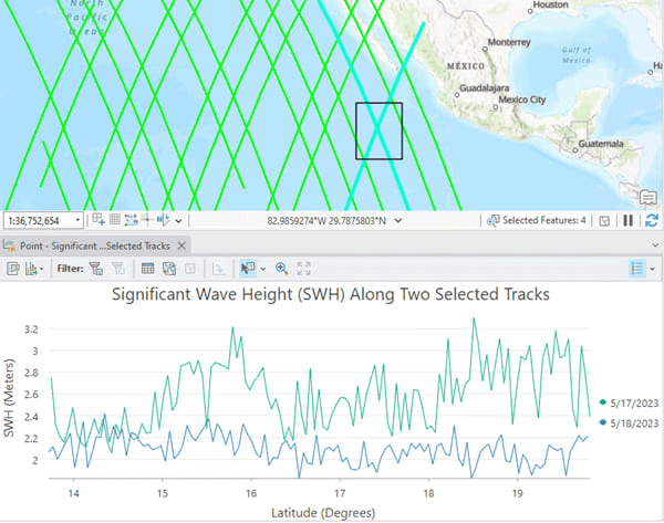

Several of these altimetry sensors offer near real-time measurements of sea surface height, significant wave height, and wind speed, facilitating operational oceanography and climate monitoring. The new Trajectory profile chart capability provides a valuable tool for quickly visualizing near real-time data. The following depicts a comparison of significant wave height from Sentinel 6 over two consecutive days along two distinct tracks.
