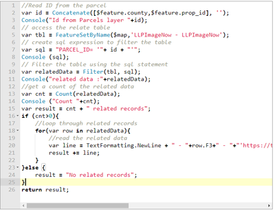

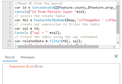

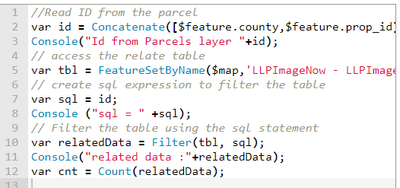

Hi @XanderBakker,
I have a feature that and a table that doesn't have a relate but has a common ID called PARCEL_ID from the table and that same id can be obtain by using concatenate please look at code below.
I am getting an error message on the count
Please advise what am I doing wrong?

I noticed that you wrote to me directly. Please have a look at the SQL query. It should follow the syntaxis of "Fieldname = value"

In my case the unique identifier is two field merge together from the feature which is corresponding to one field in the stand alone table, is that possible to use.
The console is printing out the right merge of the 2 fields. Is the last Console print right "relate data: Object, featureSet"?

Hi @utenalarosa ,
Good to know that the concatenation of the two values results in a correct id. However, the SQL needs to be changed.
On line 7 change it to this:
// change "Fieldname" by the correct name of the field
var sql = "Fieldname = @id";
// or use (assuming the field is string)
var sql = "Fieldname = '" + id + "'";
