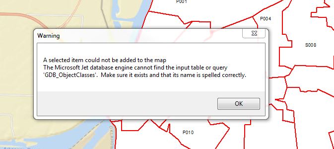

used the add data button. got this message . Tables show up in the table of contents, but no data in the map.

The MDB file looks like a simple access file, and not a Personal Geodatabase. So, there is no spatial data.
Also I couldn't find any field containing Lat./Lon. values which could have been mapped. Maybe you will need to go back to your client for shapefiles/Geodatabase/Lat./Lon. values.
NOTE: ArcMap reads Personal Geodatabase, not an MS Access File, although both have MDB extension.
