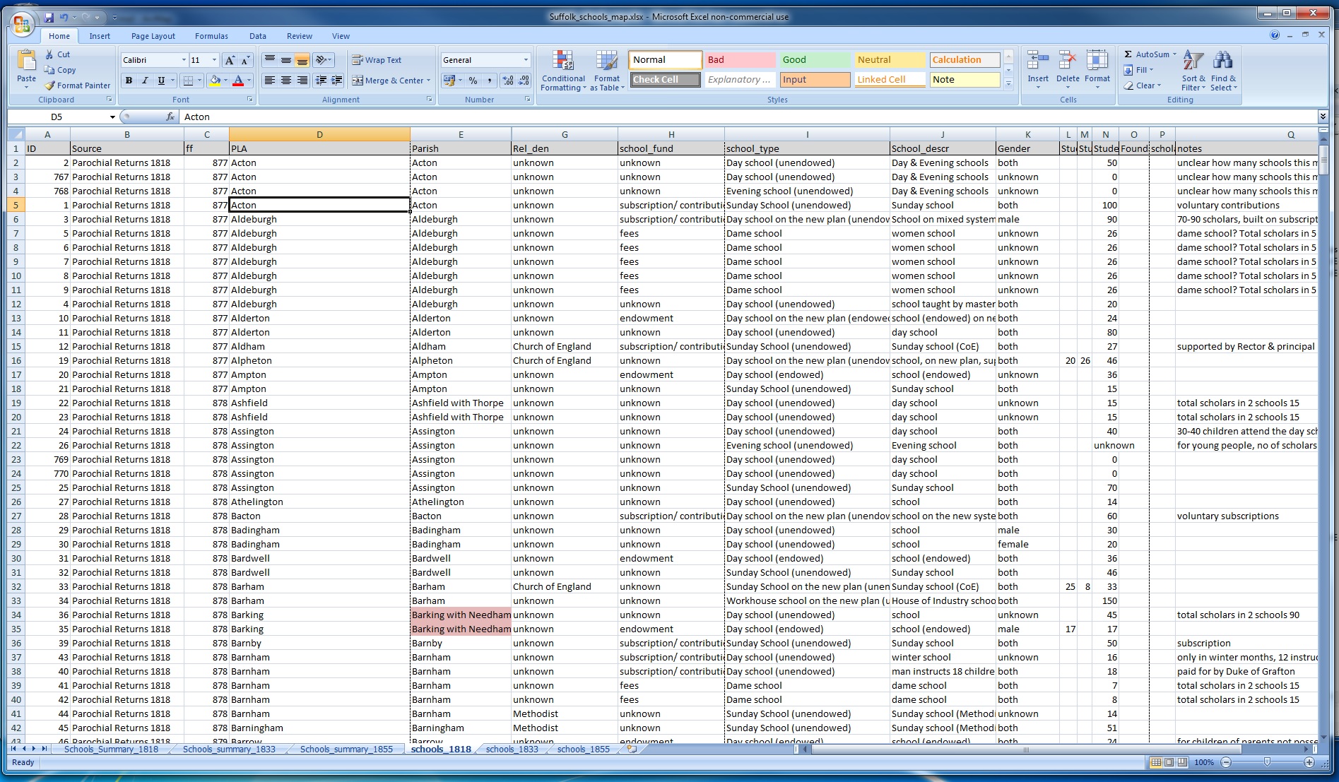

Perhaps a little more information from me would be useful. I'm working with an historical source which gives locations of crimes by parish in a county in England. Unfortunately, the location data is not more refined than that. I have a polygon shapefile of all the parishes in that county. From that shapefile I created a point shapefile. I want to show where in the county (which parishes) the crimes happen in. And I need to scatter the points so that all the crimes are represented on the map, rather than the pins being stacked on top of each other (multiple points are located in the same position).
I have successfully imported xl tables of data (called school_detail_1818) into the gdb and added them to the map. Just in case xl was the problem, I have also converted them to dbf files which worked fine. A simple join works between the shapefile and the tables ok but I need something more sophisticated to display all the crimes and to scatter the points.
I have created a feature class (Parish_Points) from the points shapefile and successfully created a relationship class between that and the table. When I open the attribute table for the point feature class it shows the relationship ok.
It seems to be just sticking on the 'make query table', when I enter the SQL expression to match the parish names in the feature class with the table. The query I have built is:
"Parish_Points.PLA_corr" = "school_detail_1818.PLA"
When I click 'verify' I get the error message: 'An expected Field was not found or could not be retrieved properly [school_detail_1818]. Persisting in spite of the error message predictably means the query table fails to build. It must be a problem with that table. I have attached a screenshot showing the fields of the table. I can't immediately see a problem with it, but there must be one. school_detail_1818.jpg

I think Helen may be right, and you need to get rid of the quote marks around the field name. I grew up in Suffolk, by the way!  For some reason, I knew it would be Suffolk before I clicked on the screen shot and read the Parish names.
