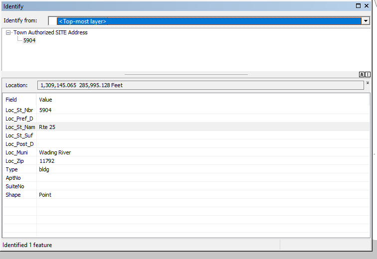

I am having trouble with adjusting the address text on our Main Map that is viewed through out our offices.
I tried to change the address in the attribute table but it will not let me.
Please see attachment- I simply need to add a "A" after 25.
What am I missing?
I am using 10.6
Thank you

So above in picture- I have started a edit session- right clicked on layer- that is highlighted in table of contents-
in the attribute table the highlighted row is where I think I would make a change to the should take place- but again I am not sure.

I assume the objective is to edit the Loc_St_Nam field.  When you click on that field in box that has Rte 25 for the highlighted record that needs to be changed to Rte 25A, by any chance does a pulldown appear?  It may be that Domains and Subtypes were applied to constrain the data entry.  If so, use the pulldown to choose Rte 25A from the list (hopefully that is one of the choices).

Thanks Chris- I narrowed it down to this I think-
I need to find how to get to the address point- then I and adjust as necessary-
How do I find the above?

Esri support solved the problem- the problem was that some of the files where versioned and some where not.
"During our call, it appeared that the feature that the edits were being attempted on were not registered as version and were also not selectable in the map document. In order to fix this we had accomplished two tasks. First, we had opened Editing options and unchecked "Edit a version of the database with the ability to undo and redo. Second, we had changed to layer in the map to selectable through the table of contents. This allowed us to update the necessary address field so changes reflected on the map."
