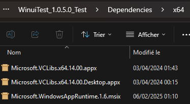

By adding <WinUISDKReferences>true</WinUISDKReferences> in the csproj, 2 VCLibs packages are published :
The app now works without the need to install VC redist.
Thanks!
