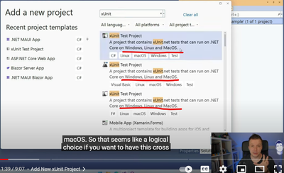

From the video you posted, it's even pointed out the limited set of platforms you can run on:
ChrisHu
addingTargetFramework "net6.0-ios" to unit test project doesn't compile due to serveral errors. One reason is that  MAUI project produces Exe instead of Dll for TargetFramework "net6.0-ios". You can't add Maui project as an project dependency to your unit test project.  Second reason is the unit test project throws compiler errors once you add "net6.0-ios", now it want you to convert your unit test project to be an iOS project by adding bundleID and other stuff. Could you please provide a sample unit test project for .net MAUI with ESRI.ArcGISRuntime.Maui installed? I believe many people have the same problem when using ESRI.ArcGISRuntime on .Net MAUI platform. Thanks

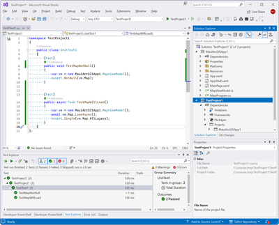

dotMorten_esri
Esri Notable Contributor
Attached is an XUnit project that should work on Windows and Mac (didn't get a chance to run it on Mac, so might need a tweak or two)
I did have an issue with setting <UseMaui>true</UseMaui>, but I don't think that's really necessary since we're bringing that dependency in implicitly via the project reference.
