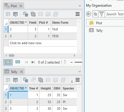

I expect 2 results from the current Plot table: 
I'm digging around the properties but the only difference I can find between them is them is:
  • Plot  = Data Type: Feature Service Feature Class
  • Tally = Data Type: Feature Service Table
Is there some sort of flag or setting I should look for?
