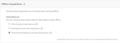

The utility network sync mode for offline map is determined from this advanced offline setting of the portal item.
This cannot be changed for ahead-of-time workflow with preplanned map area since the geodatabase is generated on the server and only downloaded on the client. But if you have 11.3 with the offline patch, there is a known limitation that it remains read-only despite the portal item advanced offline setting indicating "Trace and edit" for preplanned map area.

Side note if you're on 11.1, there is a config file you can change to see this advanced option UI see step 4 here: Offline Utility Networks in ArcGIS Maps SDKs for Native Apps: Part 2 Offline Utility Networks in Arc...
Update the config.js file to enable the utility network offline options on your ArcGIS Enterprise Portal.
Find the Home App config.js file in your Portal installation directory.
This can typically be found at the following location: C:\Program Files\ArcGIS\Portal\framework\webapps\arcgis#home\js\arcgisonline.
Using a standard text editor, find the line that reads utilNetworkOfflineOptionsEnabledand change its value from false to true.
Restart Portal for ArcGIS Enterprise.
