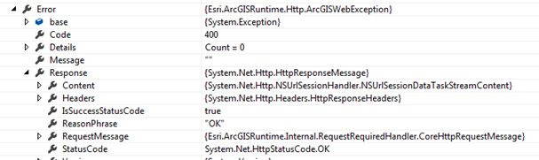

- When you get the results from the OfflineMapSyncTask, is there any errors reported in the results?
Sync is done after a new feature is added and returns job.Status = Succeeded but here is the sync result details for the feature layer:
