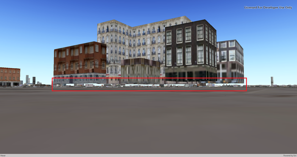

I tried  to load the local .slpk file. Its loaded successfully.
But 3D Object not rendered perfectly in base map.
Some gap is showing between base map and 3D object. like Below

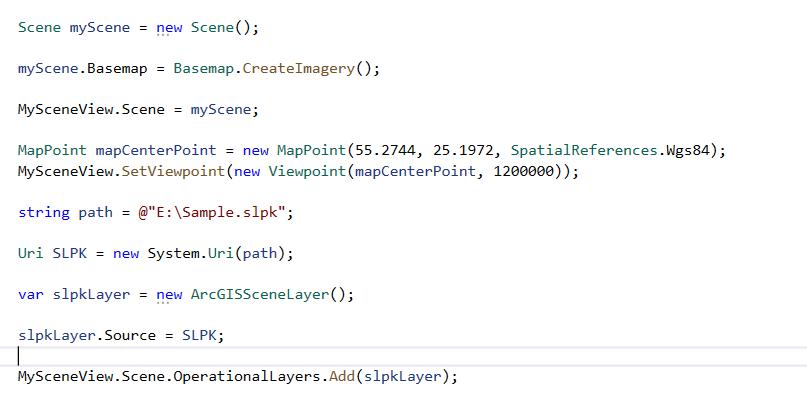

 My Code is below
Please give us advice
Thanks

It looks like you need to add an elevation source to the scene view base surface. See this sample for an example of how to do that in code: https://developers.arcgis.com/net/wpf/sample-code/get-elevation-at-a-point/
The important lines are:
Uri elevationUri = new Uri("https://elevation3d.arcgis.com/arcgis/rest/services/WorldElevation3D/Terrain3D/ImageServer");
Surface baseSurface = new Surface();
baseSurface.ElevationSources.Add(new ArcGISTiledElevationSource(elevationUri));
myScene.BaseSurface = baseSurface;
Alternatively try experimenting with the SurfacePlacement property of you "slpkLayer". For more info see https://developers.arcgis.com/net/api-reference/api/netwin/Esri.ArcGISRuntime/Esri.ArcGISRuntime.Map...

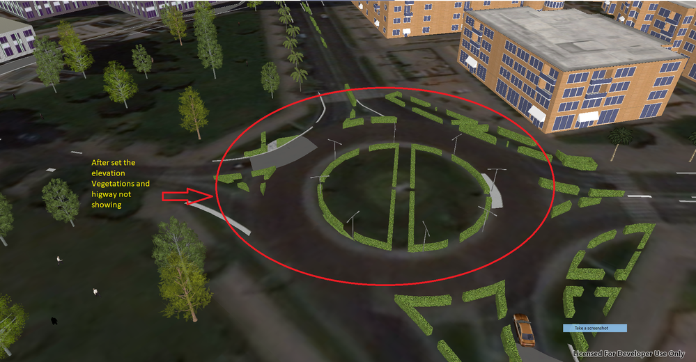

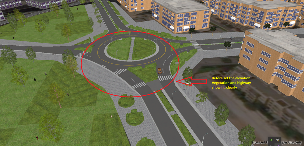

KarthikS
Thanks you  MichaelBranscomb
When i set the elevation source gap issue is resolved.
But vegetations and highways is not showing after setting the elevation source.
see the following figure
Before set the elevation sourceBefore set the elevation sourceAfter set the elevation sourceAfter set the elevation source
Thanks
