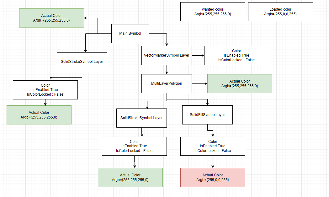

I have a MultiLayerSymbol that is built like this
To Change the color i do the following:
private void Work(MultilayerSymbol symbol, Color color)
   symbol.color = color
   foreach(var symbolLayer in symbol.SymbolLayers)
       if(!symbolLayer is VectorMarkerSymbolLayer vectorMarkerSymbolLayer)) continue;
foreach(var vectorMarkerSymbolElement in vectorMarkerSymbolLayer.VectorMarkerSymbolElements)
           Work(vectorMarkerSymbolElement.Symbol, color)
For some reason the Color property of SolidFillSymbolLayer isnt changing
P.S
event doing
symbol.Color = color; without the recursion yields the same result
PreetiMaske
I am unable to reproduce the behavior. If you can share symbol's json I will be more than happy to look at it further.
ofirrosner
Sadly i cannot share
but i managed to solved => i used ArcGis 2.8 and created the symbols again from similar examples from app6
