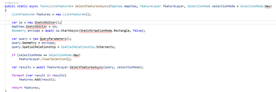

MehdiHakimi
Thank you So much,
Need load something to fix this errors?
TonyWakim
You will just need add the proper "using" statements, for example the SketchEditor would need "using Esri.ArcGISRuntime.UI;", QueryParameters would need "using Esri.ArcGISRuntime.Data" and so on.

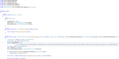

MehdiHakimi
Thank you. I added them but i have still this error.
TonyWakim
@MehdiHakimi , it looks like you are using the ArcGIS Desktop API (mapping) instead of runtime
Are you using a blend of desktop and runtime api in your application?  If not you can simply comment out the first using line.  If you are for some reason, you can try qualifying your class names by their full namespace name.
