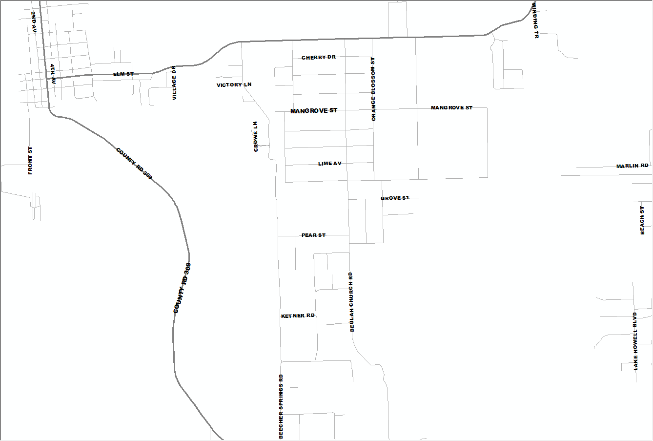

Here is a picture of a group of streets in the ArcMap application:

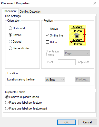

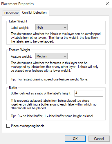

These are my label settings I use:

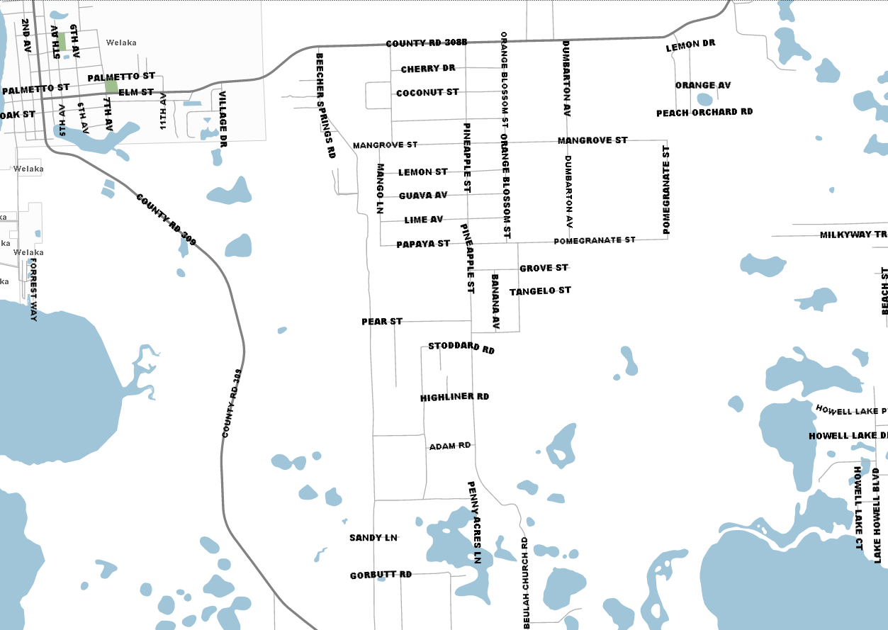

This is what the same location looks like in my app (you will notice more data in the app; I use multiple MXDs - one for basemap data, another for streets, another for structures, and another for zones):
This is too much text for what we need, and it only worsens if I put the labels above or below the line instead of on it. If I changed the buffer to 15, my app will still show this exact same image you see above. This was not happening a few months ago, and no major updates to our app have been done in 6 - 8 months.
