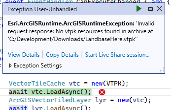

Has anyone encountered problems with VTPKs in Runtime 100.13?  I have one that works fine in Runtime 100.12, but doesn't work in Runtime 100.13 (both .NET Framework and 6).  With the VTPK itself I get this error:

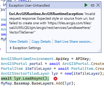

If I upload to AGOL and load the tile layer, I get this error:
I suspect that the custom projection and/or tiling scheme is causing the problem.  I created another VTPK from the same map in Web Mercator / AGOL tiling scheme, and it works fine in 100.13.  Anyway, I've attached a sample .

Hi Mark,
Thanks for reporting the problem. With the repro data , I can reproduce the problem at my end as well. have created an internal issue to look into this regression.
Thanks,
Preeti
