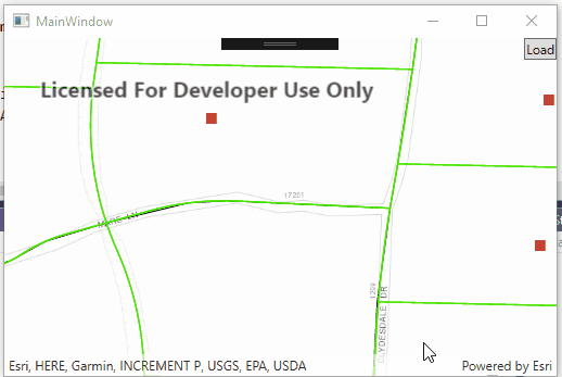

Thanks, Chad for the geodatabase. I'm unable to repro with v100.1. It seems like the first relationship reports no related features and the rest of the tables have at least one related feature. Is this what you'd expect with your data?
I used the following code.. similar code for Xamarin Android, slight differences would be namespace how you retrieve file path and display alert messages.

ChadYoder1
Thanks Jennifer, the results seem correct, but it is different from what I'm seeing.
Was your test with WPF or UWP?
I have not tried in UWP, but Android and iOS were not showing the relationships.
I can easily plug in your code into these platforms and see what I get.  I'll report back once I have a chance to test.
