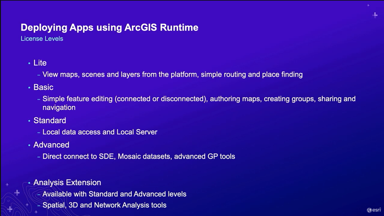

Which license level (lite, basic, standard, advanced) required for using mosaic dataset operations? We are using mosaic datasets from file geodatabase. At the image below it shows that mosaic datasets are included in advanced level. But we are not sure if it is accessible in standard license level. Thanks in advance.
(Image Source: https://youtu.be/iqaC79GsOoc?t=3621)

Hi,
The licensing summary slide applies to geoprocessing tools for working with mosaic datasets. The Local Server doc topic Supported geoprocessing tools shows how the ArcGIS Runtime license levels match up to ArcGIS Pro license levels and the list of supported tools indicate the ArcGIS Runtime license required for each tool. If you search the page for "mosaic" you see that a couple of simple mosaic tools are available at the ArcGIS Runtime Standard license level:
And then most other mosaic related tools require a ArcGIS Runtime Advanced license level:
