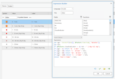

LarsNess
I forgot to add that there are 8 different symbols based on "time passed", which are defined as follows:
