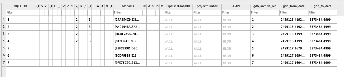

This is a look Vertex at the table in the offline database, as you can see the PipeLineGlobalID relationship field is left null:

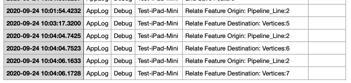

The log shows that the code to do the relate is running
