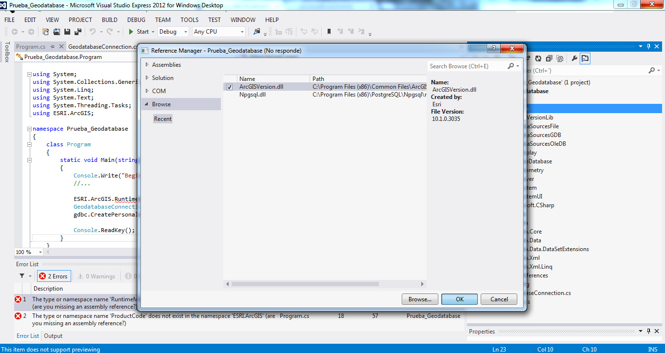

I'm trying to run a stand-alone application using ArcObjects, C# and SQLServer Express. I have an ArcGIS 10.2 Desktop license, then I did the following to bind the application:
I found the ArcGIS Version dll  (ArcGISVersion.dll) in C:\Program Files\Common Files\ArcGIS\bin\
I added the reference to this dll into my application
I included the namespace: using ESRI.ArcGIS in the class before to use any ArcObjects class.
I use the next instruction to bind the application:
ESRI.ArcGIS.RuntimeManager.Bind(ESRI.ArcGIS.ProductCode.Desktop)
The problem is I can't run the program, the compiler launched an error, RuntimeManager and ProductCode don't belong to ESRI.ArcGIS namespace and probably there is a missing assembly.

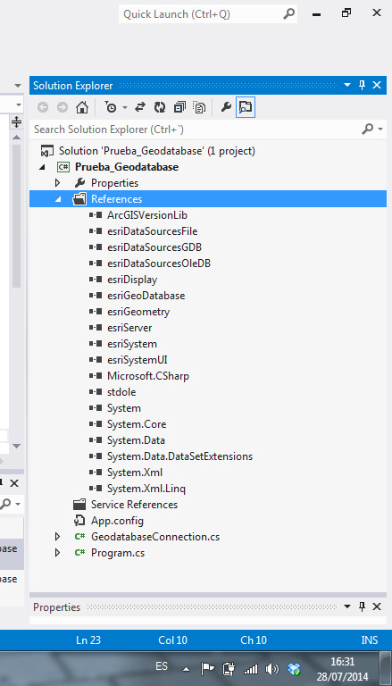

In references section appear ArcGISVersionLib instead ESRI.ArcGIS.Version. The version of the target framework is
.NET Framework 4.5

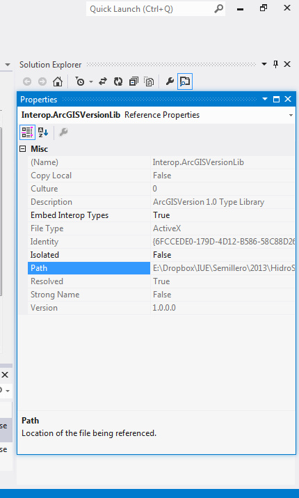

These are the properties that appear
This is a view of properties section in references
I checked the file Interop.ArcGIS.Version in the location mentioned in properties and it is on it.

I got it. I configured the target framework to 3.5.Thanks

You shouldn't be referencing ArcGisVersion.dll in your project since it is a COM dll and not a .NET assembly. This is why you have these errors during compilation. The correct file to reference is ESRI.ArcGis.Version.dll located in the same folder.

I couldn't find this dll. I searched it in the entire disk actually and I couldn't find it. Then I find  ArcGISVersion.dll as the closer dll. Then I don't know what to do
