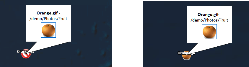

Using the .NET SDK 10.2.5, I'm creating PictureMarkerSymbols to display a placemark style graphics.  I'm setting the images for these using SetSourceAsync.  I'm finding that frequently some of the images are not loading properly/are missing (like in the image on the left).
Out of say 100 graphics, that have 100 different images, maybe 50% will load correctly.  The underlying images are there (you can see from the popup), but it's random how many of the PictureMarkerSymbols fail to load their picture and which particular images they are.
Any ideas?
Thanks
RobertKennedy
Deactivated User
Note that the pictures are from two different runs of the app (not two different graphics during the same run).  Sometimes the orange will load fine, sometimes it'll fail.

Thanks for the reply.  Unfortunately I don't think that's the root issue.  I'm using the SetSourceAsync(Uri ur) version of the call, and passing in URLs that truly are remote (http) images.  All the images are unique.
