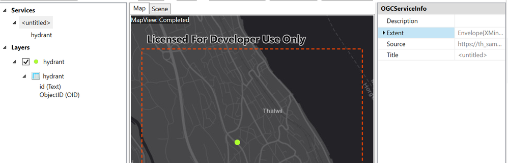

MatveiStefarov
Hello Tim!  We are working on some OGC compatibility improvements for the next 200.x release of Maps SDK.  I was able to get your service working in a development build:
I will post another update when these improvements are generally available.
