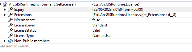

In my case the licenseResult returns a property of LicenseStatus: Valid
I can call ArcGISRuntimeEnvironemnt.GetLicense() and it returns the following
If I look at ArcGISRuntimeEnvironment.ApiKey it is set to ""

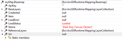

This is what the basemap shows when using CreateDarkGrayCanvasVector - no URI at all is set.
So I assume that our enterprise arcgis server has no base maps and even if it did I would need to specify a basemap which is on the same server and not use the BaseMapStyle which all go to https://basemaps-api.arcgis.com
So I either have to leave the app at 100.15.x and have this basemap or upgrade and have no base map!
