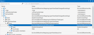

I subscribed to `MapView.LayerViewStateChanged` and get error #7003 on vector tiled layer view state changing. Could you help me please with error code meaning?
PreetiMaske
If you expand further down you could see the the error message as well via `Status` property.
Anyways, for a VTPK, that indicates we could not understand something in one of the internal files. For example, we could not parse some of the style json inside the VTPK.
It should not happen if it was directly authored from Pro.
How are the VTPKs authored for you? Did you use ArcGIS Pro ?
GKmieliauskas
The error message says:
Invalid request response: Cannot load vtpk from '/var/mobile/Containers/Data/Application/7171FE95-8F47-43D7-AC3C-2332C3EC3670/Documents/waterways/offlinecache/************.vtpk'. Message was: IO error.
Package was created with ArcGIS Pro, but I don't know which version. I will send you vtpk url for testing.
