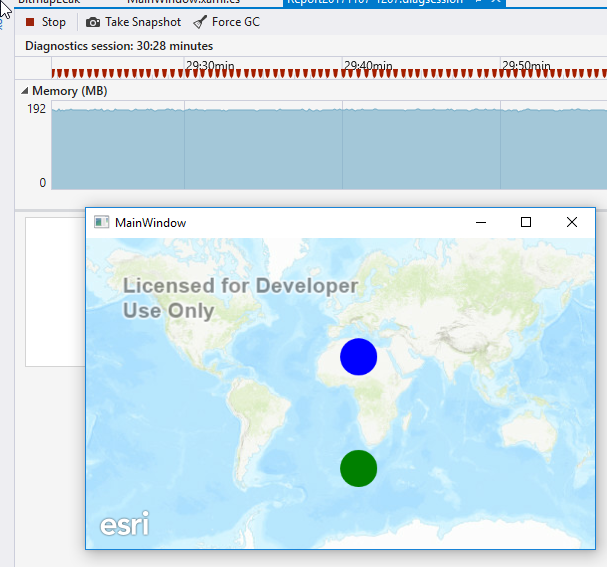

MichaelBranscomb
Esri Frequent Contributor
Hi Aaron,
Thanks for the excellent repro app. Unfortunately I am unable to the memory growth you were seeing with the 10.2.7 release. The memory profile actually looks very stable - your repro has been running for almost 30mins: memory climbed to 192MB after 5 seconds and stayed at that level.
Cheers
Mike
