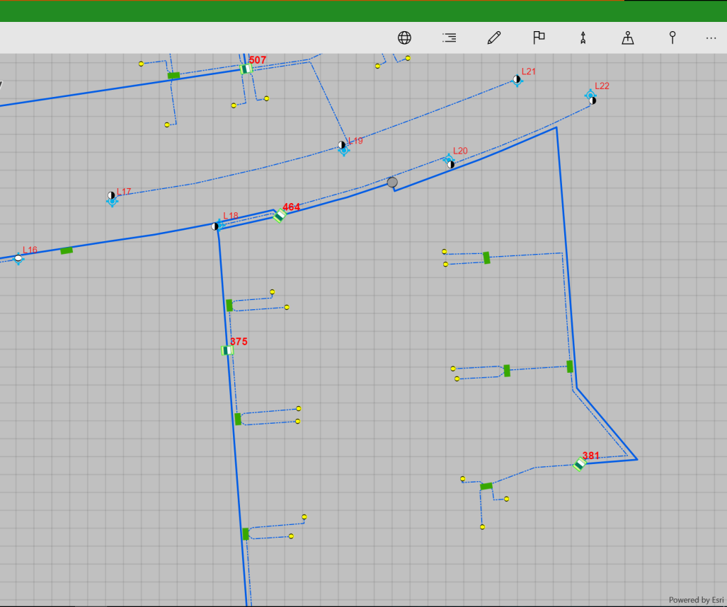

Problem 1: underground structure layer -> junction box should appear as green rectangles on map.
  • When we use mmpk, these features are not showing at all in the app (Figure 1).

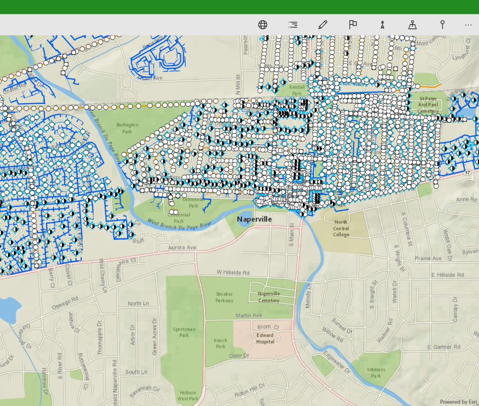

  • When we use .geodatabase (Figure 2), features are symbolized as green rectangles as expected (same as Pro).
Figure 1
Figure 2

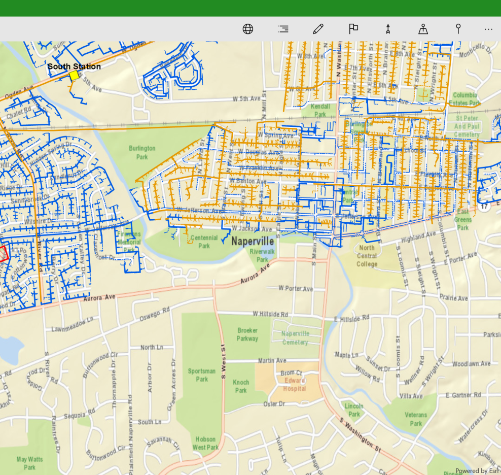

Problem 2: support structures --> poles : this layer should have scale dependency.
  • When we use mmpk, the data draw at all scales (Figure 3).

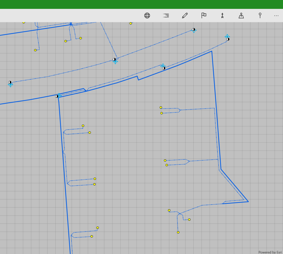

  • When we use straight .geodatabase, layer scale dependency behaves as expected (Figure 4), turning these data off when zoomed out beyond threshold scale. This is same as in Pro.
Figure 3
Figure 4
