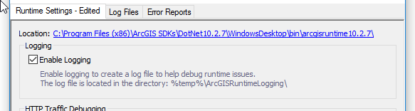

- Run "C:\Program Files (x86)\ArcGIS SDKs\DotNet10.2.7\WindowsDesktop\bin\arcgisruntime10.2.7\LocalServer64\bin\LocalServerUtility.exe"
- Check the box to enable logging:

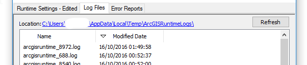

- Switch to the Log Files tab and click refresh - you see a log file has been created.
- Double click the log file to open.
- Review the messages from the LocalServer.
- You might be able to discern where the delay is from the log file.
