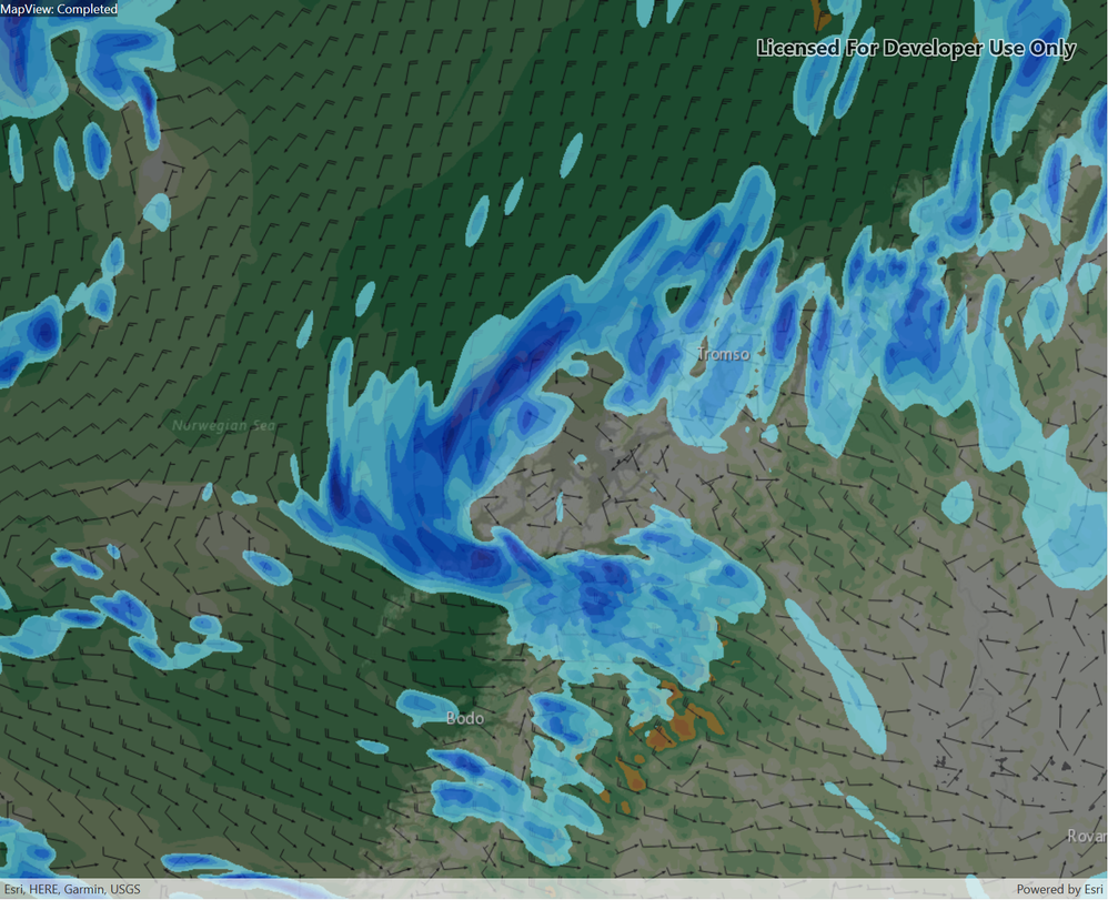

Looks like this service is also available via WMS at https://public-wms.met.no/verportal/verportal.map?SERVICE=WMS&REQUEST=GetCapabilities
I was able to use Runtime's WMSLayer to display most layers from this service:
